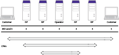

You can create hierarchical networks, or domains, and test connectivity within a domain by sending Layer 2 messages, known as CCM.
Extreme Networks uses values defined in IEEE 802.1Q-2011 for the MAC addresses and Ethernet type for CFM.
The arrows in the above figure indicate the span that CCM messages take, not the direction. (See CFM UP and DOWN MEP at the Logical Level for more information on spans for CCM messages.) This has been removed until the missing xref can be fixed.

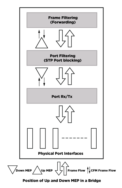

The CFM filter function (CFF) is no longer supported from ExtremeXOS 12.1. The functionality of CFF is implicitly performed by MEPs.An UP MEP sends CFM frames toward the frame filtering entity, which forwards the frames to all other ports of a service instance other than the port on which the UP MEP is configured. This is similar to how the frame filtering entity forwards a normal data frame, taking into account the port's STP state. For an UP MEP, a CFM frame exits from a port if only if the STP state of the port is in the forwarding state.
A DOWN MEP sends CFM frames directly to the physical medium without considering the port STP state. For a DOWN MEP, a CFM frame exits from a port even if the port STP state is in blocking state.
CFM UP and DOWN MEP at the Logical Level shows the concept of UP and DOWN MEP at logical level:
You must have at least one MP on an intermediate switch in your domain. Ensure that you map and configure all ports in your domain carefully, especially the UP MEPs and the DOWN MEPs. If these are incorrectly configured, the CCMs are sent in the wrong direction in your network, and you will not be able to test the connectivity within the domain.
Domains may cross VR boundaries; domains are not virtual router-aware.You assign each domain an MD level, which functions in a hierarchy for forwarding CFM messages. The MD levels are from 0 to 7. The highest number is superior in the CFM hierarchy.
All CFM messages with a superior MD level (numerically higher) pass throughout domains with an inferior MD level (numerically lower). CFM messages with an inferior MD level are not forwarded to domains with a superior MD level. Refer to the following table for an illustration of domains with hierarchical MD levels.
| MD level | 0 | 1 | 2 | 3 | 4 | 5 | 6 | 7 |
| Use | Operator | Service provider | Customer | |||||
| Superiority | Most inferior | < ----- Inferior / Superior ----- > | Most superior | |||||
